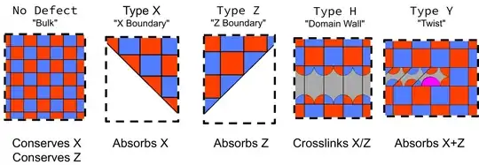

I don't know if there's a paper that explains this well, but I've been working on slides to do it: https://docs.google.com/presentation/d/1IjZ-0W9Y22wNG5036WFnnkF5Az1Zt8jTHFTC1-e7Em4/edit?usp=sharing .
This probably isn't a complete classification, but the 5 things you run into in the surface code are the bulk, the two boundary types, domain walls, and twists:
You can determine whether or not a boundary is present by checking if it's possibly to locally change the parity of the number of excitations of one type:

  • Thanks! Ok so from your definition a data qubit will belong to a $Z$ boundary if any pre-existing $Z$ excitation on the $X$-stabilizer this data qubit belongs to can be cancelled out without creating another new excitation, by applying a $Z$ excitation on this data qubit. From your definition I made the identifications of the boundaries associated to the zigzag pattern (see my edits). Could you tell me if you agree with it and if so, would you agree that there are different definitions going in the community? Maybe I simply misunderstood your explanation! – Marco Fellous-Asiani Oct 26 '22 at 09:41
    @MarcoFellous-Asiani Your edit is identifying locations where a single data error can introduce an odd number of excitations. That's a sufficient condition to identify X and Z boundaries, and in most situations it is also a necessary condition. You missed a corner circle in the top right. – Craig Gidney Oct 26 '22 at 16:01
  • Thanks. I unfortunately have other questions. 1) When you you say that my condition is sufficient but not necessary in general you mean that we could find examples in which "Z boundaries absorb Z excitations" would not imply that the sentence following "Thanks!" in my previous comment? Is there such an example in your slide? I don't find a counter example. 2) Would you say that the definition "Z boundaries absorb Z excitations" is uniformously spread in the community? – Marco Fellous-Asiani Oct 26 '22 at 18:30
  • and 3) Your definition of $Z$ boundaries seem to imply that the logical $Z$ can be defined as applying a $Z$ on each of the data qubits connecting these boundaries. Would you agree and is it always the case? My feeling is that we could have an equivalent definition of $Z$ boundaries by first defining the logical $Z$ on a boundary of the surface, and then identifying the two edges where it starts and stop. It would define the $Z$ boundary. – Marco Fellous-Asiani Oct 26 '22 at 18:30
    @MarcoFellous-Asiani For (1) it's just that the ground truth is excitation absorption, and any situation where that's possible is a boundary, even if it's not via a data error. It could be via a measurement error, for example. For (2) no I don't think it's well understood in the community, I think most people just know a few specific cases instead of the underlying logic. For (3) no that's not the case. For example, the toric code has no boundaries but it still has observables. – Craig Gidney Oct 26 '22 at 18:37
  • Allright, thanks. I start to get the idea (even though I probably need to get more intuition). – Marco Fellous-Asiani Oct 27 '22 at 09:02
