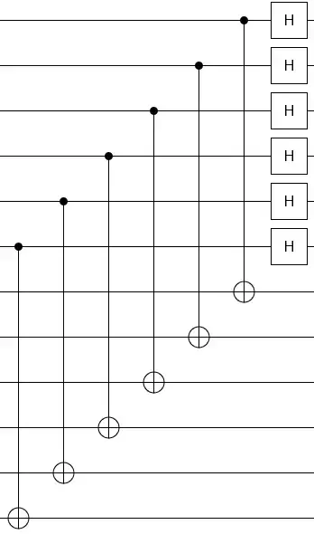

Your output size is $4^n$ numbers, so you're certainly not going to do better than $\Omega(4^n)$ complexity. At least, not without some sort of sparsity guarantee and some way to compute those big terms analogous to the sparse fast fourier transform.
Anyways, it turns out that you can get all $4^n$ numbers by interpreting your matrix as a vector and simulating applying the same quantum circuit you would apply to measure in the Bell basis. This takes $O(4^n)$ space and $O(n 4^n)$ time:
In more classical computing terms: take your matrix of coefficients, permute each column so that the entry at offset $j$ in column $k$ ends up at offset $j \oplus k$ in column $k$, then apply the classical Hadamard transform to each column (or maybe each row? I can never keep that straight). The matrix now contains the Pauli term coefficients.
