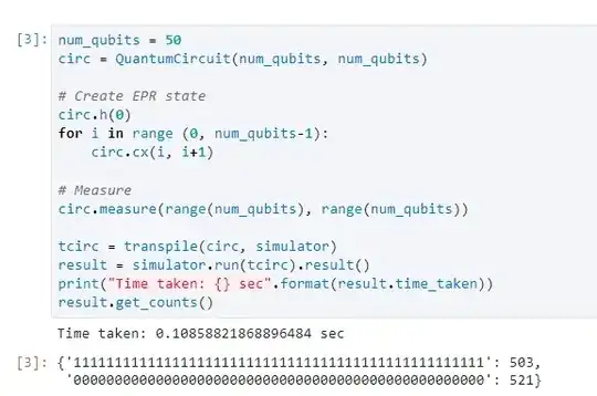

As @3yakuya has said, this is missing from the documentation.
The best I could find is a Qiskit tutorial (version 0.37.1) which uses the parameter. According to this tutorial (see the 3rd code cell), the unit of time appears to be seconds:
Screenshot from the Qiskit tutorial

  • I tried a job that took many minutes and another that took seconds to run and the `time_taken’ was pretty similar. I wonder what is it actually measuring – Mauricio Jul 30 '22 at 08:20
