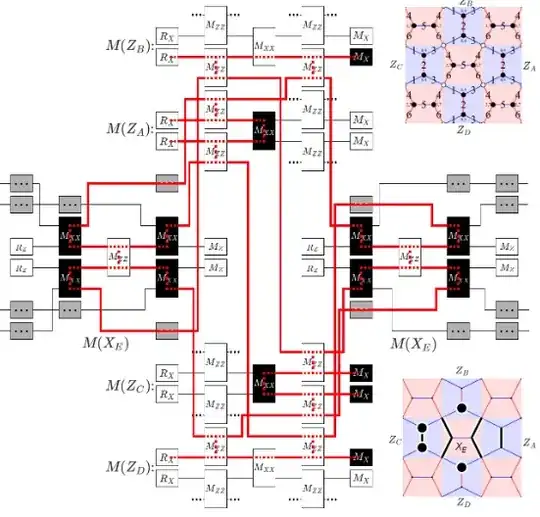

Once you know which measurements are determined, you have to figure out how to predict them. Which specific other measurements are predicting the determined measurement? It could be a single other measurement, multiple other measurements, or the empty set (as occurs during initialization). Usually you'll have a pretty good idea of which measurements to use (e.g. the previous measurement of the same stabilizer). Sometimes you'll have to more carefully trace the observables measured by measurement backwards through the circuit, and find combinations that cancel out. Sometimes it's a giant pain to get all the details exactly right. For example, in this paper I struggled to find this detector:
