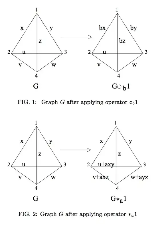

When considering $n$-qudit graph states, the equivalent graph is now weighted with adjacency matrix $A \in \mathbb{Z}_d^{n \times n}$, where $A_{ij}$ is the weight of edge $(i,j)$ (with $A_{ij}=0$ indicating no edge exists). In the qudit case, it was shown that LC equivalence can similarly be extended by the generalisation of local complementation ($\ast_a v$) and inclusion of an edge multiplication operation ($\circ_b v$), where: \begin{align} \ast_a v &: A_{ij} \mapsto A_{ij} + aA_{vi}A_{vj} \quad \forall\;\; i,j \in N_G(v), \;i \neq j \\ \circ_b v &: A_{vi} \mapsto bA_{vi} \quad\forall\;\; i \in N_G(v), \end{align} where $a, b = 1, \ldots, d-1$ and all arithmetic is performed modulo $p$.
Graphically, this is represented by the following operations (reproduced from Ref. 2):
However, if the graph state is defined on qudits of non-prime dimension, then we can see these operations (seem to) fail to represent LC-equivalence.
For example, take the qudit state $|G\rangle$ depicted the graph $G$ in Fig. 1, defined for qudit dimension $d=4$, and let $x=y=z=2$, such that $A_{12}=A_{13}=A_{14}=2$. In this case performing $\circ_2 1$ then $A_{1i} \mapsto 2 \times 2 = 4 \equiv 0 \bmod 4 \;\forall\; i$, and hence qudit $1$ is disentangled from all other qudits using only local operations. Clearly this is wrong and occurs because of the problem of zero divisors as mentioned in the previous questions' answer.

It is incorrect to use modulo arithmetic in this context. Instead finite field arithmetic should be applied. In $\textrm{GF}(4) = \{0, 1, x, x^2\}$ where $x^2 = x + 1$ and conjugation of $a$ is defined as $\bar{a} = a^2$.
Addition, multiplication and conjugation tables are then as follows:
In this picture we have $0 \equiv 0$, $1 \equiv 1$, $2 \equiv x$, and $3 \equiv x^2$ such that $2 \times 2 = 3$ and so the apparent inconsistency does not occur.
