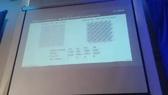

Pegasus is the first fundamental change in D-Wave's architecture since the D-Wave One.
The D-Wave Two, 2X, and 2000Q all used the "Chimera" architecture, which consisted of unit cells of $K_{4,4}$ graphs. The four generations of D-Wave machines just added more qubits by adding more and more unit cells that were the same.
In Pegasus, the actual structure of the unit cells has fundamentally changed for the first time. Instead of the Chimera graph where each qubit can have at most 6 qubits, the Pegasus graph allows each qubit to couple to 15 other qubits.
A machine has been made already with 680 Pegasus qubits (compare this to 2048 Chimera qubits in the D-Wave 2000Q).
The work was presented by Trevor Lanting of D-Wave, four days ago:
