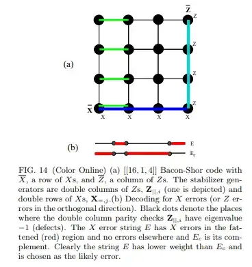

The $9$-qubit Shor code $[[9,1,3]]$ (qubits laid in a $3\times 3$ lattice) is the smallest member in the family of $m^2$-qubit Bacon-Shor code(s) $[[m^2,1,m]]$ (qubits laid in a $m\times m$ lattice). Shor's code, as you know, can correct both Pauli sign flip and Pauli bit-flip errors in a single qubit. Moreover, to correct any single-qubit error (with a high probability), it is sufficient to be able to correct against any single qubit Pauli error.[1]
Now, Bacon-Shor code(s) is(/are) a generalization of this concept to noise models where the qubits in a code block are subject to both bit-flip errors with probability $p_X$ and dephasing errors with probability $p_Z$. The noise is assumed to act independently on each qubit and the $X$ and $Z$ errors are uncorrelated.
In (Napp and Preskill, 2013) the authors find that the optimally-sized Bacon-Shor code for equal $X$ and $Z$ errors rate $p$ is given by $m=\frac{\log 2}{4p}$ and for that optimal choice they can bound the logical $X$(or $Z$) error rate as $\tilde p(p) \lesssim \exp(\frac{-0.06}{p})$[2].

Bacon-Shor codes, quantum subsystem codes which are well suited for applications to fault-tolerant quantum memory because the error syndrome can be extracted by performing two-qubit measurements. Optimal Bacon-Shor codes
Contrarily to Shor's code, these stabilizers cannot identify the precise qubit on which a bit-flip occurs, they can only identify the column in which it occurs. - Quantum Error Correction
For the $[[n^2, 1, n]]$ Bacon-Shor code the qubits are laid out in a 2D n × n square array. It is also possible to work with asymmetric Bacon-Shor codes with qubits in a n × m array. - Quantum Error Correction for Quantum Memories pg. 34
