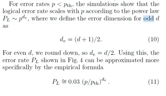

According to "Surface codes: Towards practical large-scale quantum computation" (2012) :

It makes more sense to look at odd-distance codes since the number of errors that can be corrected for a code of distance d is $\lfloor(d-1)/2\rfloor$. It’s easiest to see this in the case of a repetition code: here you can do a majority vote, and the majority will be correct as long as the number of errors is no more than $\lfloor(d-1)/2\rfloor$.
The interesting thing is that this remains correct for more complex codes such as the surface code. Intuitively you can think about the code words as spheres packed in some abstract space - the distance between spheres is about 2r, which is the code distance, and you’ll be able to associate an erroneous message with the original one as long as it remains within the radius of the original sphere.
