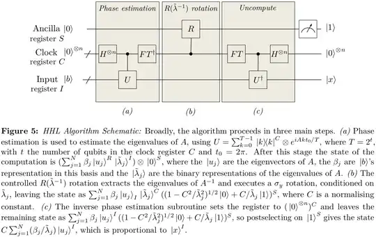

1. Definitions
Names and symbols used in this answer follow the ones defined in Quantum linear systems algorithms: a primer (Dervovic, Herbster, Mountney, Severini, Usher & Wossnig, 2018). A recall is done below.
1.1 Register names
Register names are defined in Figure 5. of Quantum linear systems algorithms: a primer (Dervovic, Herbster, Mountney, Severini, Usher & Wossnig, 2018) (reproduced below):
  • $S$ (1 qubit) is the ancilla register used to check if the output is valid or not.
  • $C$ ($n$ qubits) is the clock register, i.e. the register used to estimate the eigenvalues of the hamiltonian with quantum phase estimation (QPE).
  • $I$ ($m$ qubits) is the register storing the right-hand side of the equation $Ax = b$. It stores $x$, the result of the equation, when $S$ is measured to be $\left|1\right>$ at the end of the algorithm.

4. Hamiltonian simulation:
First of all, $\kappa$ is the condition number (Wikipedia page on "condition number") of the matrix $A$.
$\sum_{\tau = 0}^{T-1}|\tau\rangle \langle \tau|^{C}\otimes e^{iA\tau t_0/T}$ is the mathematical representation of a quantum gate.
The first part in the sum $|\tau\rangle \langle \tau|^{C}$ is a control part. It means that the operation will be controlled by the state of the first quantum register (the register $C$ as the exponent tells us).
The second part is the "Hamiltonian simulation" gate, i.e. a quantum gate that will apply the unitary matrix given by $e^{iA\tau t_0/T}$ to the second register (the register $I$ that is in the initial state $\left|b\right>$).
The whole sum is the mathematical representation of the controlled-U operation in the quantum circuit of "1. Definitions", with $U = e^{iA\tau t_0/T}$.
