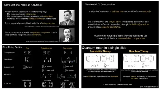

This is a good question and in my view gets at the heart of a qubit. Like the comment by @Blue, it's not that it can be an equal superposition as this is the same as a classical probability distribution. It is that it can have negative signs.
Take this example. Imagine you have a bit in the $0$ state and represent it as vector $\begin{bmatrix}1 \\0 \end{bmatrix}$ and then you apply a coin flipping operation which can be represented by a stochastic matrix $\begin{bmatrix}0.5 & 0.5 \\0.5 & 0.5 \end{bmatrix}$ this will make a classical mixture $\begin{bmatrix}0.5 \\0.5 \end{bmatrix}$. If you apply this twice it will still be a classical mixture $\begin{bmatrix}0.5 \\0.5 \end{bmatrix}$.
Now lets go to the quantum case and start with a qubit in the $0$ state which again is represented by $\begin{bmatrix}1 \\0 \end{bmatrix}$. In quantum, operations are represented by a unitary matrix which has the property $U^\dagger U = I$. The simplest unitary to represent the action of a quantum coin flip is the Hadamard matrix $\begin{bmatrix}\sqrt{0.5} & \sqrt{0.5} \\\sqrt{0.5} & -\sqrt{0.5} \end{bmatrix}$ where the first column is defined so that after one operation it makes the state $|+\rangle =\begin{bmatrix}\sqrt{0.5} \\\sqrt{0.5} \end{bmatrix}$, then the second column must be $\begin{bmatrix}\sqrt{0.5} & a \\\sqrt{0.5} & b \end{bmatrix}$ where $|a|^2 = 1/2$, $|b|^2 = 1/2$ and $ab^* = -1/2$. A solution to this is $a =\sqrt(0.5)$ and $b=-a$.
Now lets do the same experiment. Applying it once gives $\begin{bmatrix}\sqrt{0.5} \\\sqrt{0.5} \end{bmatrix}$ and if we measured (in the standard basis) we would get half the time 0 and the other 1 (recall in quantum Born rule is $P(i) = |\langle i|\psi\rangle|^2$ and why we need all the square roots). So it is like the above and has a random outcome.
Lets apply it twice. Now we would get $\begin{bmatrix} 0.5+0.5 \\0.5-0.5\end{bmatrix}$. The negative sign cancels the probability of observing the 1 outcome and a physicist we refer to this as interference. It is these negative numbers that we get in quantum states which cannot be explained by probability theory where the vectors must remain positive and real.
Extending this to n qubits gives you a theory that has an exponential that we can't find efficient ways to simulate.
This is not just my view. I have seen it shown in the talks by Scott Aaronson and I think its best to say quantum is like “Probability theory with Minus Signs” (this is a quote by Scott).
I am attaching the slides I like to give for explaining quantum (if it is not standard to have slides in an answer I am happy to write the math out to get across the concepts) enter image description here

  • I see in the other question people dont understand what i mean by interference. I'm new to stack exchange but not quantum so how do you want me to fill in more details. Either edit above or post another comment. – Jay Gambetta Jun 24 '18 at 16:34
  • ok @blue i just edit above and you can edit how you like. – Jay Gambetta Jun 24 '18 at 18:27
  • Thanks for the edit! Can you please mention the source of the slides? – Sanchayan Dutta Jun 24 '18 at 18:32
  • How do i do that. The source is me except the one i remade from seeing Scott talk. – Jay Gambetta Jun 24 '18 at 18:34
  • @JayGambetta I meant this slide: https://i.stack.imgur.com/rvoOJ.png in your answer. Can you add the source from where you got it? – Sanchayan Dutta Jun 24 '18 at 18:35
  • Sorry for being slow. I got it of my computer just now from talks i have given on this subject. This is the first place it has existed as a png :-). Maybe its simpler if i just delete and write the math out i was just being lazy. – Jay Gambetta Jun 24 '18 at 18:40
  • Ok great. Yeah i'm looking forward to trying to answer some questions on here. – Jay Gambetta Jun 24 '18 at 18:43
  • This is definitely not a layperson answer, for what it's worth. "classical probability distribution", "stochastic matrix", "unitary matrix", "quantum Born rule", etc... – TylerH Oct 02 '20 at 14:05
