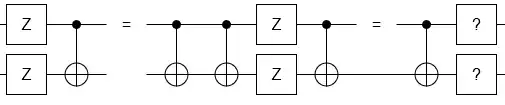

[Paraphrased: Why does $C^\dagger P C$ use $C$ twice? In the circuit it's only there once!]
Consider a Pauli product $P = Z \otimes Z$ before a CNOT $C$ in a quantum circuit:
We want to know what the CNOT transforms this Pauli product into. We want to know what the Pauli product becomes on the right hand side of the CNOT:
Note that it is always the case that $C^\dagger C = I$. In other words, we can insert a pair of CNOTs anywhere into the circuit and not change it:
But, in the middle expression, notice we can now switch our focus from "the original CNOT is the rightmost CNOT" to "the original CNOT is the leftmost CNOT". Meaning the series of operations $CNOT \cdot (Z \otimes Z) \cdot CNOT$ must equal our mystery product. And the reason there's a pair of them is because we inserted a pair of self-cancelling operations to allow ourselves to shift focus.
Another way to understand what is happening is to realize that saying
$$P_{after} = C P_{before} C^\dagger$$
is the same as saying (right multiply by $C$):
$$P_{after} \cdot C = C P_{before} C^\dagger C$$
which is the same as saying (cancel $C^\dagger C = I$)
$$P_{after} \cdot C = C \cdot P_{before}$$
In words: there was a matching mystery for why $P_{after}$ had NO cnots, instead of 1 cnot. It turns out the missing cnot was the extra cnot beside $P_{before}$. The equation was originally telling us how to move the one CNOT from one side of the Pauli product to the other, and then we solved for $P_{after}$ which rearranged things.

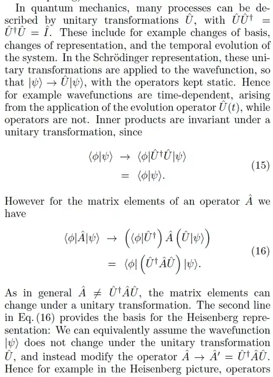

A quote in Fowler, Mariantoni, Martinis, and Cleland, 2012, "Surface codes: Towards practical large-scale quantum computation" (page 22) a few pages earlier than my question. I refer to the CNOT as the unitary operation, and to the middle 2Q operation as the not unitary A. So:
