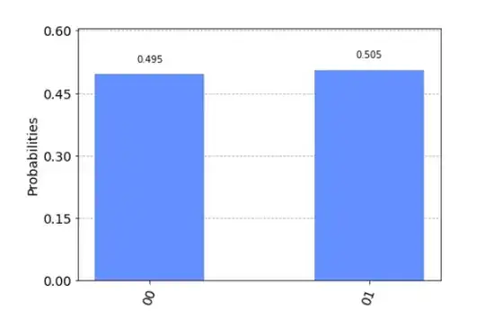

This shows that in a simulation, I have a given probability of getting either $|00\rangle$, $|10\rangle$ or $|11\rangle$ . Yet, this is what happens:

No matter the parameters used, I never get a single $|11\rangle$ state. For exmaple, using the parameters
[np.pi/2, 3*np.pi/4]
results in the following histogram:
Somehow I am thinking that my calculations are wrong, but am not sure. Specially considering that I've done the same thing with $CRY(\theta)$ inversed (so, control qubit is $q_0$ and target is $q_1$), and the results are the same.

    Maybe you should check again that making q0 the control doesn't work, because your problem is definitely that using q1 as the control means the operations does nothing because q1 is in the 0 state. – Craig Gidney Oct 27 '21 at 21:38
The probabilities plot you have at the end is correct. You can see this by two ways, intuition or explicit calculation of the circuit.
1. Intuition:
The second qubit, $q_1$ start in the state $|0\rangle$ and it acts as a control. Thus, it will not change, that is, it will remain in the state $|0\rangle$. Which matches what you have in the probabilities plot. The first qubit undergoes some changes because of the $RY$ gate so hence you expect it to be in the superposition of $|0\rangle$ and $|1\rangle$, which also matches with that plot in your question.

This is different than what you had. The matrix you had is $CRY_{01}$. The controlled is the first qubit and the target is the secon qubit. Here the control qubit is the second qubit and the target is the first qubit. Now, note that
$$ \begin{pmatrix} 1 & 0 & 0 & 0\\ 0 & \cos \theta/2 & 0 & -\sin\theta/2 \\ 0 & 0 & 1 & 0\\ 0 & \sin \theta/2 & 0 & \cos \theta/2 \end{pmatrix} \begin{pmatrix} \cos\frac{\alpha}{2} \\ 0 \\ \sin\frac{\alpha}{2} \\ 0\end{pmatrix} = \begin{pmatrix} \cos\frac{\theta}{2} \\ 0 \\ \sin\frac{\theta}{2} \\ 0\end{pmatrix} = \cos\frac{\theta}{2}|00\rangle + \sin\frac{\theta}{2}|10\rangle $$
But in Qiskit, it uses little Endian, so you see $|10\rangle$ as $|01\rangle$ instead.

    You're right, that was my intuition too. But I thought that maybe some sort of mystery was acting on my qubits :P
    So basically all I had was the endians mixed up which made me pick the wrong matrix. Oh well, thanks a lot!
