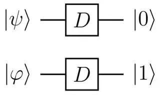

When tackling the first part, we'll start by giving a precise representation to the quantum gate for distinguishing between $|\psi\rangle$ and $|\varphi\rangle$. We will denote this gate by $D$. It can be seen that the gate defined by the following two circuits satisfies the criteria for distinguishing.
Quantum circuits describing the gate, D, for distinguishing non-orthogonal states psi and phi
Each of these two circuits represents two scalar equations, giving us four equations to uniquely determine the $2\times 2$ matrix representation of $D$. Let $$|\psi\rangle=a|0\rangle+b|1\rangle$$ $$|\varphi\rangle=c|0\rangle+d|1\rangle$$ where $a\overline{c}+b\overline{d}\neq0$, $a\overline{c}-b\overline{d}\neq0$, and $|a|^2+|b|^2=|c|^2+|d|^2=1$. These requirements on $a,b,c,d$ ensure that $|\psi\rangle$ and $|\phi\rangle$ are not orthogonal nor coincident and have probability amplitudes that sum to one. The circuits yield the following system of equations $$D_{11}a+D_{12}b=1$$ $$D_{21}a+D_{22}b=0$$ $$D_{11}c+D_{12}d=0$$ $$D_{21}c+D_{22}d=1$$ which has the solution $$D=\frac{1}{ad-bc}\begin{bmatrix} d & -c \\ -b & a \end{bmatrix}$$ Upon testing whether or not $D$ is unitary by checking if $D^\dagger D=I$, we immediately discover why such a gate cannot be made. $D^\dagger D=I$ if and only if $|\psi\rangle$ and $|\phi\rangle$ are orthogonal, since the off-diagonals of $D^\dagger D$ have $ac+bd$ as their numerators. Thus, when $|\psi\rangle$ and $|\phi\rangle$ are not orthogonal, $D$ is not unitary and therefore it is not a physical quantum gate. Since this question is non-physical in nature, due to breaking the laws of physics like the no-cloning theorem, we will suspend our disbelief and suppose that $D$ is unitary anyway. This will enable us to employ $D^{-1}=D^\dagger$ despite its numerical representation being unsolvable. We can now construct our cloning circuit. For $|x\rangle\in\{|\psi\rangle,|\varphi\rangle\}$ the following circuit will clone $|x\rangle$

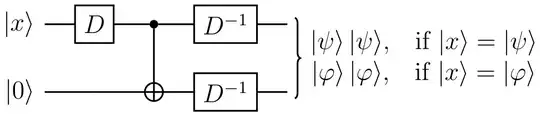

A circuit that clones psi and phi given a distinguishing gate.
When $|x\rangle$ passes through the $D$ gate, it will be transformed into $|0\rangle$ if $|x\rangle=|\psi\rangle$ and $|1\rangle$ if $|x\rangle=|\varphi\rangle$. The CNOT gate will then flip the second bit if $|x\rangle$ was originally $|\varphi\rangle$ and will keep it at $|0\rangle$ if $|x\rangle$ was originally $|\psi\rangle$. Thus, before the final $D^{-1}$ gates, we have the 2-qubit state $|0\rangle|0\rangle$ or $|1\rangle|1\rangle$. The $D^{-1}$ gates transform this into $|\psi\rangle|\psi\rangle$ or $|\varphi\rangle|\varphi\rangle$. Therefore, this circuit satisfies the criteria of being a cloner composed of distinguishing gates.
