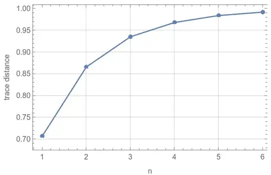

For example, if you take $\rho=|0\rangle\!\langle0|$ and $\sigma=|+\rangle\!\langle+|$ and compute the trace norm $\|\rho^{\otimes n}-\sigma^{\otimes n}\|_1$ as a function of $n$ (which you'll remember from the linked post, and the discussion in this post, gives you the maximum distinguishing probability), you get

The figures above were generated with the following MMA snippets:
KP[arg_] := arg;
KP[args___] := KroneckerProduct[args];
traceDistance[dm1_, dm2_] := dm1 - dm2 // Eigenvalues // Abs // Total // #/2 &;
With[{rho = {{1, 0}, {0, 0}}, sigma = {{1, 1}, {1, 1}}/2},
  Table[
    traceDistance[KP @@ ConstantArray[rho, n], KP @@ ConstantArray[sigma, n]],
    {n, Range@6}
  ] // ListPlot[#,
    Joined -> True, PlotMarkers -> Automatic,
    GridLines -> Automatic, PlotRange -> All, Frame -> True,
    FrameLabel -> {"n", "trace distance"}] &
and
