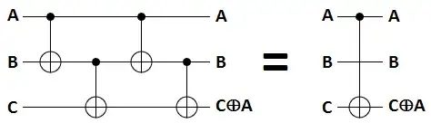

The two most evocative types of proofs, to me, are proofs based on circuit identities and proofs based on ZX calculus diagrams.
For circuit identities, you start with a swap and then just keep doing obviously correct things like "CZ = CNOT with target conjugated by hadamards" until you get to teleportation.
For the ZX calculus, the proof is almost laughably trivial. All you do is draw a squiggly line, then a line, and put an equals sign between them. All the hard work was already done in setting up the machinery of the diagrams in the first place.
If you want to be a little more rigorous and properly model the Pauli corrections, instead of assuming they can just be dealt with, you end up showing that the following graph equals the two-lines graph under the ZX rewrite rules (from https://members.loria.fr/VZamdzhiev/slides/quilt.pdf ):
