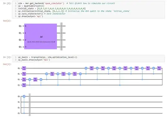

I have added an image for your reference. If you have to create any state but don't know the circuit then you can always initialize the state then using qiskit transpile, you can decompose the circuit in terms of basis gates
