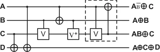

I have come across most of the quantum circuit which contains gate such as controlled $V$ and $V^{\dagger}$ but I dont know how to code it in Qiskit.
The above image is the zplg gate circuit

  • What's the V gate again? :) – Cryoris Jun 23 '21 at 11:23
  • @Cryoris I think $V$ gate in this case should be $Rx(\pi/2)$. Look at section 1.2 here: https://arxiv.org/pdf/1509.03962.pdf But hopefully the OP can clarify. – KAJ226 Jun 23 '21 at 15:05
  • Illustration seems to come from this paper. I do not have access to it, could someone check it and verify it is really a $Rx(\pi /2)$ ? – BrockenDuck Jun 23 '21 at 15:47
  • @BrockenDuck The image is indeed coming from that paper. It is Figure 21 to be specific. On page 5, section 1.2 of the paper, it is stated that " $V$ is a square root of the NOT gate". And $R_X^2(pi/2)$ is indeed equivalent to $X$ up to an overall phase.... – KAJ226 Jun 23 '21 at 16:13
  • But overall phase does matter in controlled gate.... that is $Controlled-U$ is not the same as $Controlled-e^{i\theta}U$. – KAJ226 Jun 23 '21 at 16:17

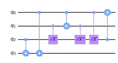

$V$ is the square root of $X$. That is,
\begin{align*} V = \sqrt X = \frac{1}{2}\left( {\begin{array}{*{20}{c}} {1 + i}&{1 - i}\\ {1 - i}&{1 + i} \end{array}} \right) \end{align*}
It is implemented in Qiskit with the name $SX$. So, the circuit in your question is easy to implement:
from qiskit import QuantumCircuit
from qiskit.circuit.library import SXdgGate
qc = QuantumCircuit(4)
qc.cx(2, 3) qc.cx(0, 3)
qc.csx(1, 2) qc.cx(0, 1)
csxdg_gate = SXdgGate().control() qc.append(csxdg_gate, [1, 2])
qc.csx(0, 2) qc.cx(2, 0)
qc.draw('mpl')
