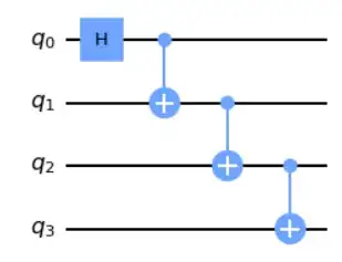

As to how to create entangled states, the most easy way to do this is with the following circuit:
qc = QuantumCircuit(4)
qc.h(0)
qc.cx(0, 1)
qc.cx(1, 2)
qc.cx(2, 3)
This is an example for $n=4$, and you get the state $\frac{1}{\sqrt{2}}(|0\rangle^{\otimes 4} + |1\rangle^{\otimes 4})$; as confirmed by the statevector_simulator.
svsim = Aer.get_backend('statevector_simulator')
result = svsim.run(qc).result().get_counts()
Output: {'0000': 0.5, '1111': 0.5}
Of course, you can extend this circuit to any number of qubits and get $\frac{1}{\sqrt{2}}(|0\rangle^{\otimes n} + |1\rangle^{\otimes n})$. Now, this is not a efficient way of doing this since the number of CNOT gates is $n-1$, thus error on these gates plus decoherence time of the qubits on real devices will affect your state. However, this is the way to do it. For more information on this, check this answer and the GHZ state page on Wikipedia.
