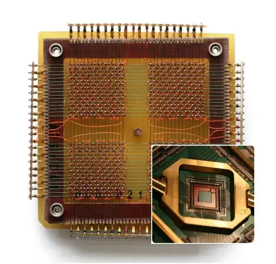

Look at this image of a magnetic memory and a quantum processor - quite different from an x86 processor:
Which is which?
