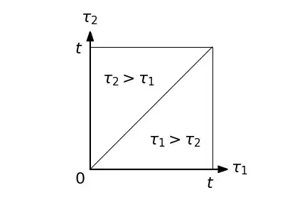

Now consider the square $[0,t] \times [0,t] \subseteq \mathbb{R}^2$.
square
Observe that the first term of $X_2$ above is a Riemann sum of the operator-valued function \begin{equation}\tag{2}\label{eq:F1} F(\tau_1, \tau_2) \equiv H(\tau_1) H(\tau_2) \end{equation} in the interior of the lower-right triangle where $\tau_1 > \tau_2$. You want to extend the definition of $F(\tau_1, \tau_2) $ to the upper-left triangle in such a way that its integral over the upper-left triangle is the same as the integral in the lower triangle. This of course is done by using the time-ordering "operator" $\mathcal{T}$:
\begin{equation}\tag{3}\label{eq:F2} F(\tau_1, \tau_2) \equiv \mathcal{T} \Big[ H(\tau_1) H(\tau_2) \Big] = \begin{cases} H(\tau_1) H(\tau_2) & \text{if $\tau_1 > \tau_2$}\\ H(\tau_2) H(\tau_1) & \text{otherwise} \end{cases} \end{equation}
The operator $\mathcal{T}$ does nothing in the lower-right triangle because there the order $\tau_1 > \tau_2$ is respected (so Eq. \eqref{eq:F2} properly defines an extension of Eq. \eqref{eq:F1}), and "corrects" the order that applies in the other triangle (that is $\tau_2 > \tau_1$) so that the Riemann sums of $F$ over the two triangles are the same. Now you can use this fact $$ -\sum_{i \neq j} \mathcal{T}\Big[ H(\tau_i) H(\tau_j) \Big] (\Delta \tau)^2 = -2\sum_{i>j} \mathcal{T}\Big[ H(\tau_i) H(\tau_j) \Big] (\Delta \tau)^2 $$ and that $\mathcal{T}$ acts trivially if $\tau_i=\tau_j$ to rewrite $X_2$ above as \begin{align} X_2 & = -\sum_{i \neq j} \frac{1}{2!}\mathcal{T}\Big[ H(\tau_i) H(\tau_j) \Big] (\Delta \tau)^2 - \sum_{i} \frac{1}{2!} \mathcal{T}\Big[ H(\tau_i) H(\tau_i) \Big] (\Delta \tau)^2\\ & = -\sum_{i, j=0}^{k-1} \frac{1}{2!}\mathcal{T}\Big[ H(\tau_i) H(\tau_j) \Big] (\Delta \tau)^2 \xrightarrow{k \rightarrow \infty} \frac{(-i)^2}{2!} \int_0^t \int_0^t \mathcal{T} \Big[ H(\tau_1)H(\tau_2) \Big] \,\mathrm{d}\tau_1 \, \mathrm{d}\tau_2 \end{align}
At this point the generic case should be clear, at least in principle: at the $m$-th order you will have an $m$-dimensional cube $[0,t]^m \subseteq \mathbb{R}^m$ split in $m!$ simplices. Each simplex is defined by the specific ordering of the $m$ coordinates $\tau_1,\ldots,\tau_m$ that holds inside of that simplex. The $m$-th term $X_m$ in the series will contain a Riemann sum of $F(\tau_1,\ldots,\tau_m) \equiv H(\tau_1)\cdots H(\tau_m)$ taken over one of these simplices (call it the "fundamental simplex") where the $m$ coordinates $\tau_j$ are ordered according to the order given in Eq. \eqref{eq:ordered}, as well as some boundary terms. Then one has to extend the definition of $F$ over the full hypercube, while using the time-ordering operator $\mathcal{T}$ to "correct back" the order in each simplex to the order in the fundamental simplex. In this way the Riemann sum of the extension of $F$ in each simplex will be the same. After taking care of the additional boundary terms between the simplices, then one will be able to write $X_m$ as the full Riemann sum over $[0,t]^m$ of the operator-valued function $F(\tau_1,\ldots,\tau_m) \equiv \mathcal{T}[ H(\tau_1) \cdots H(\tau_m)]$, modulo the combinatorial factor $1/m!$ that corrects the overcounting obtained from integrating $F$ over all simplices instead of just one. By taking the $k \rightarrow \infty$ limit of the Riemann sum you get $$ X_m \xrightarrow{k \rightarrow \infty} \frac{(-i)^m}{m!} \int_{0}^t \cdots \int_{0}^t \mathcal{T}\Big[ H(\tau_1) \cdots H(\tau_m) \Big] \mathrm{d}\tau_1 \cdots \mathrm{d}\tau_m $$ This is precisely the $m$-th term of the Dyson series, whose sum defines the time-ordered exponential $$ U(t) = \mathcal{T} \exp\Big(-i\int_0^t H(\tau)\, \mathrm{d}\tau \Big) $$ so in the limit of $k \rightarrow \infty$ Eq. \eqref{eq:ordered} (in the right-to-left time ordering) correctly gives the unitary propagator generated by the time-dependent Hamiltonian $H(t)$.
