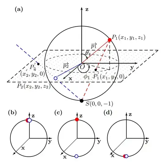

Majorana Sphere - Dogra, Dorai, and Arvind
FIG. 1. A qutrit on the Majorana sphere is represented by two points $P_1$ and $P_2$, connected with the center of the sphere by lines shown in red and blue respectively. $\theta_1$, $\phi_1$ are the polar and azimuthal angles corresponding to point $P_1$ ($\theta_2$, $\phi_2$ are the angles for point $P_2$). (a) Roots of the Majorana polynomial are shown in the plane $z = 0$ by points $P'_1$ and $P'_2$, whose stereographic projection give rise to the Majorana representation. Three examples are shown corresponding to the Majorana representation of single-qutrit basis vectors $(b)\;\vert+1\rangle$, $(c)\;\vert0\rangle$ and $(d)\;\vert-1\rangle$. One of the points is shown as a solid (red) circle, while the other point is represented by an empty (blue) circle.

Compare that to the complexity of the Bloch sphere depicted in: "Bloch-sphere representation of three-vertex geometric phases". The shape is the same it's all how you visualize the projection used.
Here's a less busy image:
Bloch sphere
Think of the Bloch sphere cut in half by a very large sheet of paper. At the edge of the paper (infinity) any point on the top of the sheet draws a line to (infinity) the top of the ball (the bottom of the ball for the underside of the sheet). Points nearest the center of the paper (mixed states) draw lines to the center of the sphere. That represents the distance up to infinity on a tiny ball, a qubit/qudit is finite so the paper is not so big.
Now draw points on the 2D paper, draw lines from the paper to the ball, remove the paper, and look at or through the clear ball to see the other endpoint of the line.
A much more accurate and difficult explanation is offered in the links above.
