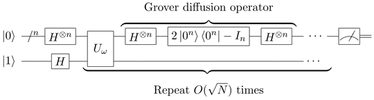

From experience I know this can be achieved by sandwiching a large controlled Z, with target on last logical qubit that isn't the oracle qubit, by H and X gates like so:
I have no earthly idea how I would have figured that out from the instructions "${\displaystyle 2|s\rangle \langle s|-I}$"
