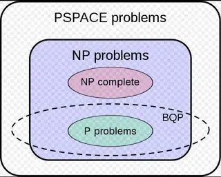

TL;DR: No, we do not have any precise "general" statement about exactly which type of problems quantum computers can solve, in complexity theory terms. However, we do have a rough idea.
According to Wikipedia's sub-article on Relation to to computational complexity theory
The class of problems that can be efficiently solved by quantum computers is called BQP, for "bounded error, quantum, polynomial time". Quantum computers only run probabilistic algorithms, so BQP on quantum computers is the counterpart of BPP ("bounded error, probabilistic, polynomial time") on classical computers. It is defined as the set of problems solvable with a polynomial-time algorithm, whose probability of error is bounded away from one half. A quantum computer is said to "solve" a problem if, for every instance, its answer will be right with high probability. If that solution runs in polynomial time, then that problem is in BQP.
BQP is contained in the complexity class #P (or more precisely in the associated class of decision problems P#P), which is a subclass of PSPACE.
BQP is suspected to be disjoint from NP-complete and a strict superset of P, but that is not known. Both integer factorization and discrete log are in BQP. Both of these problems are NP problems suspected to be outside BPP, and hence outside P. Both are suspected to not be NP-complete. There is a common misconception that quantum computers can solve NP-complete problems in polynomial time. That is not known to be true, and is generally suspected to be false.
The capacity of a quantum computer to accelerate classical algorithms has rigid limits—upper bounds of quantum computation's complexity. The overwhelming part of classical calculations cannot be accelerated on a quantum computer. A similar fact takes place for particular computational tasks, like the search problem, for which Grover's algorithm is optimal.
Bohmian Mechanics is a non-local hidden variable interpretation of quantum mechanics. It has been shown that a non-local hidden variable quantum computer could implement a search of an N-item database at most in ${\displaystyle O({\sqrt[{3}]{N}})}$ steps. This is slightly faster than the $\displaystyle O({\sqrt {N}})$ steps taken by Grover's algorithm. Neither search method will allow quantum computers to solve NP-Complete problems in polynomial time.
Although quantum computers may be faster than classical computers for some problem types, those described above can't solve any problem that classical computers can't already solve. A Turing machine can simulate these quantum computers, so such a quantum computer could never solve an undecidable problem like the halting problem. The existence of "standard" quantum computers does not disprove the Church–Turing thesis. It has been speculated that theories of quantum gravity, such as M-theory or loop quantum gravity, may allow even faster computers to be built. Currently, defining computation in such theories is an open problem due to the problem of time, i.e., there currently exists no obvious way to describe what it means for an observer to submit input to a computer and later receive output.
As for why quantum computers can efficiently solve BQP problems:
  1. The number of qubits in the computer is allowed to be a polynomial function of the instance size. For example, algorithms are known for factoring an $n$-bit integer using just over $2n$ qubits (Shor's algorithm).
  2. Usually, computation on a quantum computer ends with a measurement. This leads to a collapse of quantum state to one of the basis states. It can be said that the quantum state is measured to be in the correct state with high probability.
Interestingly, if we theoretically allow post-selection (which doesn't have any scalable practical implementation), we get the complexity class post-BQP:
In computational complexity theory, PostBQP is a complexity class consisting of all of the computational problems solvable in polynomial time on a quantum Turing machine with postselection and bounded error (in the sense that the algorithm is correct at least 2/3 of the time on all inputs). However, Postselection is not considered to be a feature that a realistic computer (even a quantum one) would possess, but nevertheless postselecting machines are interesting from a theoretical perspective.
I'd like to add what @Discrete lizard mentioned in the comments section. You have not explicitly defined what you mean by "can help", however, the rule of thumb in complexity theory is that if a quantum computer "can help" in terms of solving in polynomial time (with an error bound) iff the class of problem it can solve lies in BQP but not in P or BPP. The general relation between the complexity classes we discussed above is suspected to be:
$\text{P $\subseteq$ BPP $\subseteq$ BQP $\subseteq$ PSPACE}$
However, P=PSPACE, is an open problem in Computer Science. Also, the relationship between P and NP is not known yet.

There is no such general statement and it is unlikely there will be one soon. I will explain why this is the case. For a partial answer to your question, looking at the problems in the two complexity classes BQP and PostBQP might help.
The complexity classes that come closest to the problems that can be solved efficiently by quantum computers of the quantum gate model are
  1. BQP; and
  2. PostBQP
BQP consists of the problems that can be solved in polynomial time on a quantum circuit. Most important quantum algorithms, such as Shor's algorithm, solve problems in BQP.
PostBQP consists of the problems that can be solved in polynomial time on a quantum circuit that can additionally perform postselection. This is a lot more powerful, as PostBQP$=$PP, a class that contains BQP.
However, there currently are no methods to practically implement postselection, so PostBQP is more of theoretical interest.
The relation between P, NP and BQP is currently unknown; and an open problem on the order of P vs. NP. As a general statement about what kinds of problems can be solved more efficiently using quantum computers must answer the BQP vs. P question (if BQP=P, then apparently quantum computers aren't more efficient (to complexity theorists, at least) )
