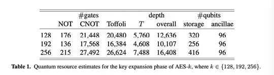

The authors construct quantum gate implementations of AES-128, AES-192 and AES-256. They Do it with Clifford+T gates "as the underlying fault-tolerant logical quantum gate set." Table 1 has their gate estimates and qubit estimates for the key expansion.

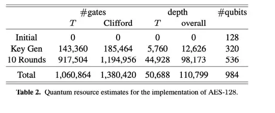

Table 2 has the quantum resource estimates for the AES-128 implementation:
