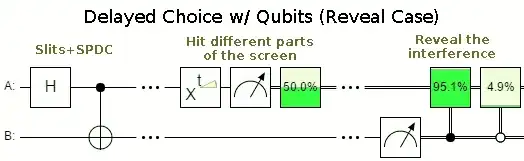

Quirk includes a mockup of the delayed choice eraser as an example circuit:
example circuit
Any situation where you create an entangled state, and then switch between measuring in the same basis on both sides or a different basis will show the effect. You can reduce it down to fewer qubits if you're willing to give up the more visually direct waves in the output expectation:
reveal erase
