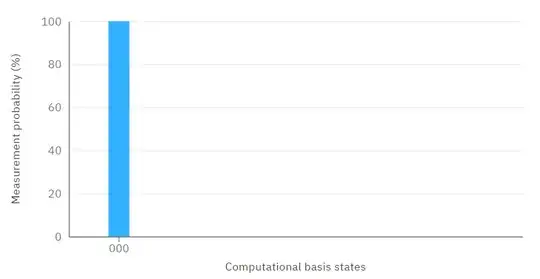

However, when I looked at the measurement probabilities, it looked like this:
I don't think this is supposed to be the case, as superposition distributes the probability of being 0 and 1. When I removed the measurement like this:

  • Welcome to QCSE! My guess is that measurement collapses the state and for some reason software post-selects on the zero outcome. This is suggested by the zero on the c3 wire. – Adam Zalcman Jan 06 '21 at 05:41

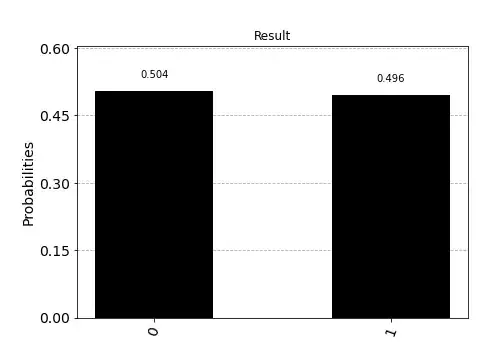

It is true that the hadamard gate create the superposition state $\dfrac{|0\rangle + |1\rangle}{\sqrt{2}}$ when applied to the state $|0\rangle$, and you should see the state collapses to the state $|0\rangle$ or $|1\rangle$ upon measurement with 50% probability. That is, you should see something like this:

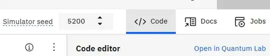

However, if you apply the measurement operator within the Circuit Composer within IBM Quantum Experience, then you might not experience this. That is, you will see that it always collapses to the state $|0\rangle$ instead. However, you can fix this issue by changing the Simulator seed within the composer as commented by @luciano in this related question here https://quantumcomputing.stackexchange.com/a/15367/9858.
By doing this, you will see that the state will collapse to $|1\rangle$ or $|0\rangle$.

This will give you the probability plot I shown at the beginning.
