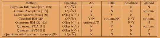

It seems like there are a number of different speed-ups for different machine learning algorithms:
But has anyone created an algorithm showing speed-up for neural networks? A similar question was asked a few years ago, but the answer is not so clear. It seems like it is an open problem as of 2014, and was interested in knowing if there have been any recent developments that demonstrate speedup.
