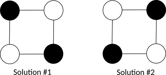

The 'Hello World' equivalent in the D-Wave world is the 2D checkerboard example. In this example, you are given the following square graph with 4 nodes:
                                                  square_graph
Let's define that we colour vertex $\sigma_{i}$ black if $\sigma_{i} = -1$ and white if $\sigma_{i} = +1$. The goal is to create a checkerboard pattern with the four vertices in the graph. There is various ways of defining $h$ and $J$ to achieve this result. First of all, there are two possible solutions to this problem:

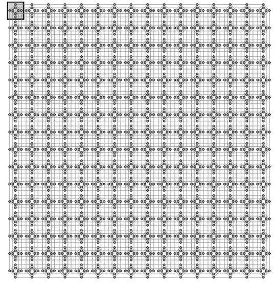

I recommend using the D-Wave 2000Q Virtual Full Yield Chimera (VFYC) which is a fully functional chip without any dead qubits! Here's the Chimera chip layout:
dwave_chimera
At this point I am splitting the tutorial into two distinct pieces. In the first section, we are manually embedding the problem onto the Chimera hardware graph and in the second section we are using D-Wave's embedding heuristics to find a hardware embedding.

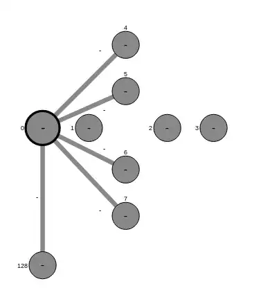

The unit cell in the top left corner on the D-Wave 2000Q chip layout above looks like this:
physical_qubits
Note, that not all couplers are visualized in this image. As you can see, there is no coupler between qubit $0$ and qubit $1$ which we would need to directly implement our square graph above. That's why we are now redefining $0\rightarrow0$, $1\rightarrow4$, $2\rightarrow7$ and $3\rightarrow3$. We then go on and define $h$ as a list and $J$ as a dictionary:
J = {(0,4): 1, (4,3): 1, (3,7): 1, (7,0): 1}
h = [-1,0,0,0,0,0,0,0,0]
$h$ has 8 entries since we use qubits 0 to 7. We now establish connection to the Solver API and request the D-Wave 2000Q VFYC solver:
