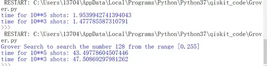

Another way is rather interesting, I think the shots number only influence the running time slightly. Here comes my observation:
The first case is to search the number 24 from the range [0,31], the second case is to search number 64 from the range [0,127], the last one is printed on the figure (in my code, the number of qubits needed is 3*len(bin(24/64/128)[2:]), three times of the binary length).
According to this observation, I think the time-consuming part of computing is to get the state vector, and the role this 'shot' variable plays is to generate output based on the state vector. So, if you just want to save the running time of your script, maybe you do not need to change the number of shots.
NOTICE that this test is not sophisticated, loopholes maybe continue hidden.
