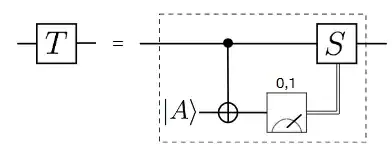

In addition to the accepted answer and @user1271772's examples, here is a circuit primitive referred to explicitly as a "T-gate gadget" in [1] (originally appearing in [2]):
T-gate gadget: IMAGE SOURCE:arXiv:1601.07601
where application of the $S$ gate is conditioned on measuring a "1" on the ancilla. The way this works is, for $|A\rangle = \frac{1}{\sqrt{2}} (|0\rangle + e^{i\pi/4} |1\rangle)$, an input state $| \psi \rangle = a|0\rangle + b|1\rangle$ coming in from the left is transformed like:
$$ (a|0\rangle + b|1\rangle)(|0\rangle + e^{i\pi/4} |1\rangle) \rightarrow a|00 \rangle + a e^{i\pi/4} |01 \rangle + b|11\rangle + b e^{i\pi/4}|10 \rangle \\ = (a|0 \rangle + b e^{i\pi/4} |1\rangle )|0\rangle + (a e^{i\pi/4} |0\rangle + b|1\rangle)|1\rangle $$
If the ancilla is measured as "0", the input state is projected onto $(a|0 \rangle + b e^{i\pi/4} |1\rangle ) = T|\psi\rangle$ and the gate succeeds. If the ancilla is measured as "1" you apply an $S$ gate on the input register to get
$$ S(a e^{i\pi/4} |0\rangle + b|1\rangle) = (a e^{i\pi/4} |0\rangle + e^{i\pi/2} b|1\rangle) = e^{i\pi/4} (a |0\rangle + e^{i\pi/4} b|1\rangle) = e^{i\pi/4} T |\psi \rangle $$
which recovers the desired $T$ gate up to a global phase.
This process falls under the umbrella of gate teleportation (based on normal quantum teleportation) and basically lets you apply non-clifford gates if you have access to states that contain the essential information about the gate you want to apply - for instance, $|A\rangle = T\frac{1}{\sqrt{2}}(|0\rangle + |1\rangle)$ contains the effects of the $T$ gate that we want to apply.
