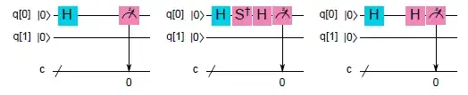

Please find here circuits for measurement in z (computational), y (circular) and x (Hadamard) bases:
Source: Quantum Algorithm Implementations for Beginners, pg. 68.
Note that the blue Hadamard gate is used for preparing state $|+\rangle$ which is then measured. Pink gates are those needed for measuring in different basis. So, measurement in z basis needs no additional gate (left circuit), measuring in y basis needs $S^\dagger$ and $H$ additional gates (middle circuit) and measuring in x basis needs additional $H$ gate (right circuit).

    The blue Hadamard gate is a part of the circuit because the question asked about the measurement of the $\vert+\rangle$ state in the Y-basis. The gates in pink are the ones that correspond to making the measurement - Just wanted to put this out there in case somebody looks at the first circuit and thinks it's performing a Hadamard basis measurement instead of a computational basis measurement. – agiri Sep 07 '20 at 05:34
    @AdityaGiridharan: Thanks for your comment. Based on it, I made my answer clearer. – Martin Vesely Sep 07 '20 at 06:46
  • Please can you share the post measurement values in each of the three cases? – Kittu A Nov 26 '21 at 18:48
    @KittuA: In the first case, the probability of both $|0\rangle$ and $|1\rangle$ is 50% as Hadamard gate prepares state $\frac{1}{\sqrt{2}}(|0\rangle + |1\rangle)$. The second case is the same as the first case since $HS^\dagger|+\rangle =\frac{1}{2}(1 - i, 1 + i)^T$ and $[(1/2)|1-i|]^2=[(1/2)|1-i|]^2 = 0.5$ (you can verify this with direct calculation). In the third case, the resulting state is $|0\rangle$ with 100% probablity as $H^2 = I$. – Martin Vesely Nov 26 '21 at 22:46
