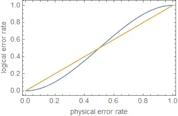

To me there seem to be two parts of this question (one more related to the title, one more related to the question itself):
1) To which amount of noise are error correction codes effective?
2) With which amount of imperfection in gates can we implement fault-tolerant quantum computations?
Let me firs stress the difference: quantum error correction codes can be used in many different scenarios, for example to correct for losses in transmissions. Here the amount of noise mostly depends on the length of the optical fibre and not on the imperfection of the gates. However if we want to implement fault-tolerant quantum computation, the gates are the main source of noise.
On 1)
Error correction works for large error rates (smaller than $1/2$). Take for example the simple 3 qubit repetition code. The logical error rate is just the probability for the majority vote to be wrong (the orange line is $f(p)=p$ for comparison):
plot physical vs logical error rate
So whenever the physical error rate $p$ is below $1/2$, the logical error rate is smaller than $p$. Note however, that is particularly effective for small $p$, because the code changes the rate from $\mathcal{O}(p)$ to a $\mathcal{O}(p^2)$ behaviour.
