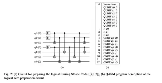

Here's a direct circuit to produce the logical $\bar{|0\rangle}$ state from https://arxiv.org/abs/1501.02524:
I'm not a qiskit expert, but in Cirq, I can check the superposition created by this:
import cirq
q = cirq.LineQubit.range(7) state = cirq.Circuit( cirq.H(q[0]), cirq.H(q[1]), cirq.H(q[3]), cirq.CNOT(q[0], q[2]), cirq.CNOT(q[3], q[5]), cirq.CNOT(q[1], q[6]), cirq.CNOT(q[0], q[4]), cirq.CNOT(q[3], q[6]), cirq.CNOT(q[1], q[5]), cirq.CNOT(q[0], q[6]), cirq.CNOT(q[1], q[2]), cirq.CNOT(q[3], q[4]), ).final_state_vector(0, qubit_order=q) print(cirq.dirac_notation(state))
results in
0.35|0000000⟩ + 0.35|0001111⟩ + 0.35|0110011⟩ + 0.35|0111100⟩ + 0.35|1010101⟩ + 0.35|1011010⟩ + 0.35|1100110⟩ + 0.35|1101001⟩
