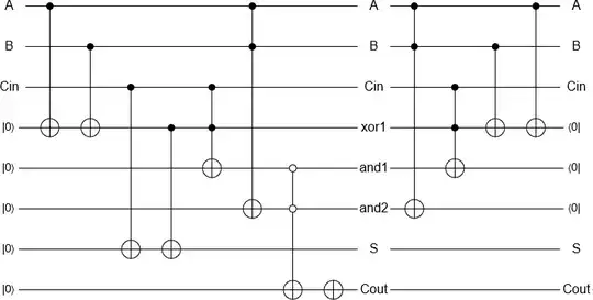

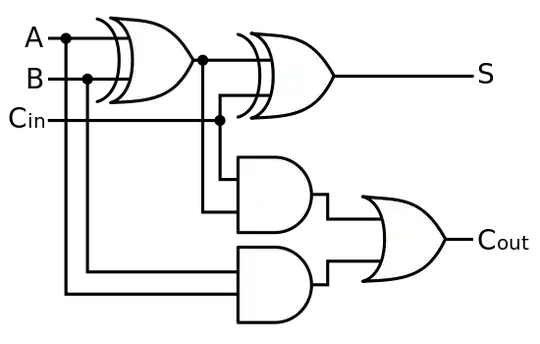

Here is my process for doing arithmetic on a quantum computer.
Step 1: Find a classical circuit that does the thing you're interested in.
In this example, a full adder.
classical full adder
Step 2: Convert each classical gate into a reversible gate.
Have your output bits present from the start, and initialize them with CNOTs, CCNOTs, etc.
semi-reversible full adder
Step 3: Use temporary outputs.
If you were doing this addition to e.g. control whether a Grover oracle phases by -1 or not, now is the time to apply a Z gate to your output qubit.
Step 4: Get rid of intermediate values by doing exactly the opposite of what you did to compute them.
This may or may not include getting rid of the output bits, depending on how the circuit fits into your overall algorithm.
semi-reversible full adder 2
Step 5: (Sometimes) for each output bit you keep, get rid of an input bit.
And I don't mean "drop them on the floor", I mean apply operations that cause them to become 0 for sure.
When you compute c+=a, leaving behind a copy of the original value of c tends to be bad. It destroys coherence. So you must look at your adder circuit (or whatever), and think hard about if there's a way to use your output bits to get rid of your input bits. For example, after computing c+a you could do a temporary out-of-place subtraction into a register r, xor r into the register storing the unwanted copy of c, then revert the temporary subtraction.
(A notable exception to "if you keep your output, don't keep so much of your input" is Shor's algorithm. Shor's algorithm decoheres its input on purpose, but in a very particular way that helps with period finding.)
Step 6: Be efficient
In step 5 I said you could uncompute the input of an inplace addition by doing an out of place addition followed by a temporary out-of-place subtraction. This is a bit silly. The overall adding process is going to span 4n qubits (n to hold a, n to hold c, n to hold c+a, n to hold (c+a)-a). If you are more clever, you can fit everything into 2n qubits or (slightly easier) into 2n+1 qubits:
cuccaro adder
