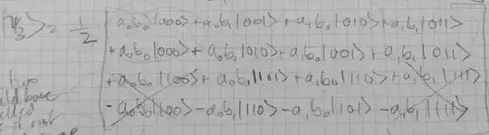

As I'm new to this I decided to do the expansion by hand.
The first two rows are grouped for $\vert 0xx\rangle$ and the second two rows are for $\vert 1xx\rangle$. As I understand, I can get $P(|0⟩_{\psi_3})$ by summing the probability amplitudes for the first two rows.
Here's what's baffling me:
The first two rows are basically what you would get back if you skipped the controlled-swap. You'd just come back to $|\psi_0⟩$. And as before, you'd get:
$$ P(|0⟩_{\psi_0}) = |a_0b_0| + |a_0b_1| + |a_1b_0| + |a_1b_1| $$
So that means the probability amplitudes of the first two rows sum up to 1. Which leaves me very confused because there are still two more rows to consider which would add on another $|a_0b_1| + |a_1b_0|$.

  • First of all count the terms with 0, you can see from counting that 1/2 of the terms will result in 0, this gives you the first part of the expression for P = 1/2 + .... , – Sam Palmer Jun 05 '20 at 14:23
  • @SamPalmer thanks for jumping in on this one. I think it hasn't quite clicked with me yet. I see 8 terms with 0. Within the brackets, the first 4 coefficients will sum to 1, and then the next 4 will also sum to 1 because they are the same. Then that's 1/2*(2) = 1 (but of course it's not because that would break quantum mechanics, so I did something wrong) – Alexander Soare Jun 05 '20 at 14:27
    No worries I got it! Thank you – Alexander Soare Jun 05 '20 at 14:43
    Sorry I was looking at this on my phone, the first four do not sum to 1, because remember you are multiplying by the normalisation factor of 1/2, so you are summing $1/2a_nb_m$, also from a simple permutations argument you can see that half of the terms will have 0. – Sam Palmer Jun 05 '20 at 14:43

Found it! To me it actually feels very sneaky so I'll take the time to explain it.
Focussing on just the top two rows of my handwritten expansion:
I made the mistake of taking vertically adjacent pairs of coefficients, adding them together, and dividing by 2.
So from left to right in vertical pairs:
$$ \frac{1}{2}\big[2a_0b_0|0xx⟩\big] + \frac{1}{2}\big[2a_0b_1|0xx⟩\big] + \frac{1}{2}\big[2a_1b_0|0xx⟩\big] + \frac{1}{2}\big[2a_1b_1|0xx⟩\big] \tag{1A} $$
Then I just cancelled the 2's and was left with:
$$ |a_0b_0| + |a_0b_1| + |a_1b_0| + |a_1b_1| = 1 \tag{2A} $$
hence my confusion.
The mistake was made when I did the grouping for the first |0⟩ disregarding the rest of the state. But if we look at the columns 2 and 3 we see that the 2nd and 3rd qubits are inverted, so I can't do the grouping. The proper way of what I meant to do in (1A) would then be:
$$ \frac{1}{2}\big[2a_0b_0|000⟩\big] + \frac{1}{2}\big[a_0b_1|001⟩\big] + \frac{1}{2}\big[a_0b_1|010⟩\big] + \frac{1}{2}\big[a_1b_0|010⟩\big] + \frac{1}{2}\big[a_1b_0|001⟩\big] + \frac{1}{2}\big[2a_1b_1|011⟩\big] \tag{1B} $$
And actually once you take the norms with these coefficients you get
$$ |a_0 b_0|^2 + \frac{1}{2} | a_0 b_1 + a_1 b_0 |^2 + |a_1 b_1|^2 \neq 1 \tag{2B} $$
And that makes up the gap.
