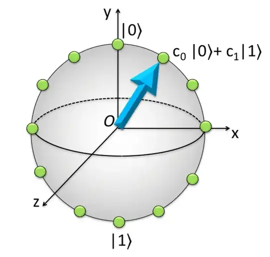

Page 1: "Introduction. The quantum phase space of a qubit is a sphere (Fig. 1). One can discretize this space into any number of states and then apply field pulses to switch between the chosen states in an arbitrary order. In this sense, a qubit comprises the whole universe of choices for computation. For example, a qubit can work as finite automata when different unitary gates act on this qubit depending on arriving digital words. However, different states of a qubit are generally not distinguishable by measurements. So, if the final quantum state encodes the result of computation, we cannot generally extract this information because we cannot distinguish this state by a measurement from other non-orthogonal possibilities reliably. For such reasons, qubits are believed to provide computational advantage over classical memory only when they are used to create purely quantum correlations, i.e., entanglement or quantum discord."
"Quantum mechanically, distinguishable states must be represented by orthogonal vectors that produce definitely different measurement outcomes. However, the switching time between two orthogonal quantum states is restricted from below by a fundamental computation speed limit T = h/(4∆E), where ∆E is characteristic energy of the control field coupling to the memory that is needed to update one bit of information. So, restrictions on strength of control fields automatically restrict the speed of classical computation that saves information in physically distinguishable states. While the existence of this computation quantum speed limit is a mathematically proved fact, I will show an explicit elementary example that demonstrates possibility of solving a computational problem faster than the lowest time bound that is imposed by this limit on classical computation hardware. Access to the quantum memory makes this possible because it allows information processing using nonorthogonal quantum states. So, there is no more direct linear relation between the minimal time and the number of elementary logic operations required to implement an algorithm at given energy constraints.
Qubit's quantum phase space
FIG. 1. Up to overall phases that do not influence measurement outcomes, states of a qubit correspond to points on the 2D sphere. This phase space can be discretized to create a register of states (green circles) for computation. However, only opposite points on this sphere, such as the poles marked by |0and |1, are distinguishable by measurements.
