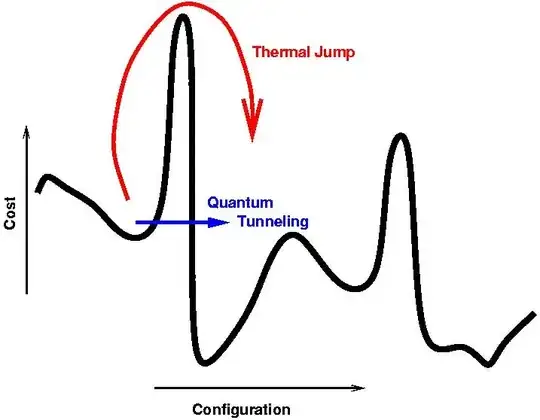

Annealing's more of an analog tactic.
The gist is that you have some weird function that you want to optimize. So, you bounce around it. At first, the "temperature" is very high, such that the selected point can bounce around a lot. Then as the algorithm "cools", the temperature goes down, and the bouncing becomes less aggressive.
Ultimately, it settles down to a local optima which, ideally, is favorably like the global optima.
Here's an animation for simulated annealing (non-quantum):
But, it's pretty much the same concept for quantum annealing:
By contrast, gate-logic is far more digital than analog. It's concerned with qubits and logical operations rather than merely finding a result after chaotic bouncing-around.
