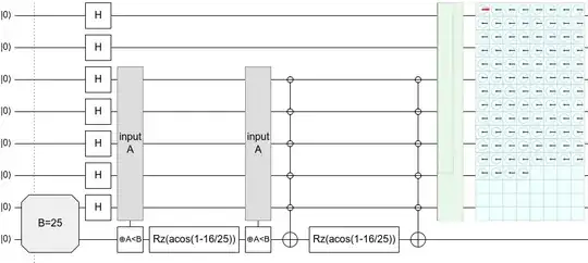

For large $N$ the most efficient method I am aware of is to prepare a uniform superposition over $2^{\lceil \log_2(N) \rceil}$ values with a bunch of Hadamard gates, then use a perfectly tuned Grover diffusion step to remove the unwanted states between $N$ and $2^{\lceil \log_2(N) \rceil}$. The cost of this approach is $O(\log N + \log 1/\epsilon)$ gates (the $1/\epsilon$ is from arbitrary angle rotations being approximated using a fixed gate set).
This method is explained in Figure 12 of https://arxiv.org/abs/1805.03662. Beware that there is a sign error in the figure. The numerator in the angle calculations should be $L - 2^{\lfloor \log(L)\rfloor}$ instead of $ 2^{\lfloor \log(L)\rfloor} - L$.
Here is a working example in Quirk, preparing a uniform superposition over 100 values. 100 is $25*2^2$, so this really reduces to the $N=25$ case with two $|+\rangle$ qubits. The perfect angle for the diffusion is $\arccos(1 - 16/25)$, where the 25 comes from $N=25$ and 16 is the smallest power of 2 less than $N$.
Quirk circuit
You can confirm that the construction works by clicking on the image to open quirk, changing the three "25"s in the circuit to "23"s, and seeing that the new output is a uniform superposition up to 4*23 = 92.
Craig Gidney
  • 36,389
  • 29
  • 95
