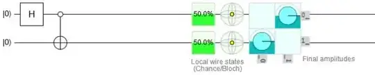

Starting from the $2$ qubit state $|00\rangle$ I'd like to end with $\frac1{\sqrt 2}(|01\rangle+|10\rangle)$, which is accomplished by the following circuit:
Everything unitary! Since it was addresed in on of the answers: What happens to $|10 \rangle$? It revertibly maps to $\frac1{\sqrt 2}(|01\rangle-|10\rangle)$.
