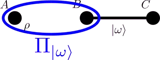

  2. Now project systems $A$ and $B$ on $|\omega\rangle$:
    [This can be understood as a teleportation where we have only consider the "good" outcome, i.e., where we don't have to make a (generalized) Pauli correction on $C$, see also the discussion.]
    Our intuition on teleportation (or a simple calculation) tells us that we now have the state $\rho$ in system $C$:

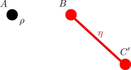

  1. Apply $\mathcal E$ to $C$, which is the right part of $|\omega\rangle$:
    This results in a state $\eta=(\mathbb I\otimes \mathcal E) (|\omega\rangle\langle\omega|)$, which is nothing but the Choi state of $\mathcal E$:
    (This is the original step 3.)
  2. We can now carry out the original step 3: Project $A$ and $B$ onto $|\omega\rangle$:
    Doing so, we obtain $\mathcal E(\rho)$ in $C'$:
Steps 4 and 5 are exactly the Choi-Jamiolkowski isomorphism:

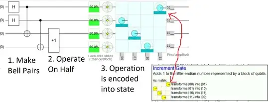

For an n-qubit operation it means:
  1. Prepare n Bell pairs $a_k, b_k = |00\rangle + |11\rangle$.
  2. Take one qubit $a_k$ from each pair, and apply $U$ to those qubits $a_1, a_2, ..., a_n$.
  3. The state of all of the qubits $a_1, b_1, ... a_n, b_n$ now encodes the operation $U$.
Quirk makes this particularly blatant, because the way it displays superpositions results in the final state even looking like the matrix of the operation:
Quirk example
