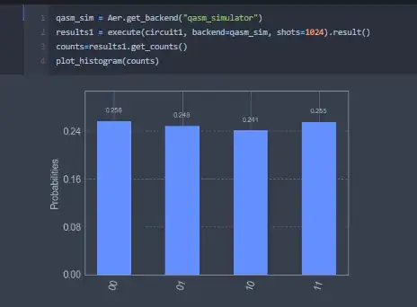

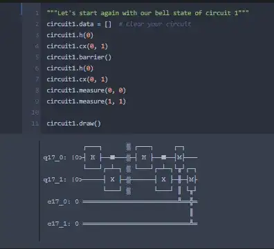

but it does't seem to work as I thought it would:
By doing the math I understand that it should give this, but what I don't understand is my reasoning to why it is so. That is, why was I wrong thinking that the above circuit would return all the measurements in the $|00\rangle$?

I have found my mistake, and hopefully it may help more people. It lies on the fact that $(AB)^\dagger=B^\dagger A^\dagger$. Having done so, my result is as expected. But any more enlightening answer is more than welcome.
