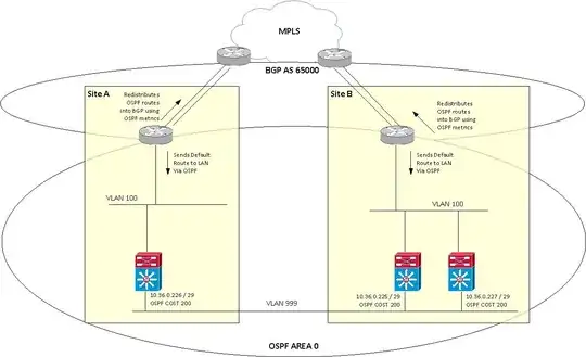

enter image description hereWhen I did something similar I did not use eBGP between the routers. I had the BGP speaking router only send the default route down to the Site A and Site B routers via OSPF and then redistribute the OSPF routes into BGP. On the link between the two sites I applied an OSPF cost.
This allows Site A to have routes to its networks, Site B networks, and a default route to get out of Site A (the OSPF cost keeps the default route from Site B as a secondary option should you lose the Site A link). Site A will talk directly to site B, not using MPLS unless there is a link failure between the sites.
As well, the OSPF costs translate into the BGP MED during redistribution which causes the carrier MPLS network to prefer sending Site A traffic directly to Site A but also use Site B to get to Site A if need be.
