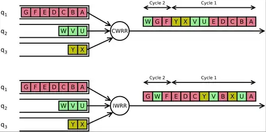

What does a scheduler do. It organizes this buffer memory in a more sophisticated structure than a single queue. Let's use the bottom part of this image from wikipedia as an example.
example of weighted round robin
So, basically instead of one queue there are several queues and packets land in different queues based on some criteria (the process is usually called classification). For example, packets of a single flow (e.g., single tcp flow) land in the same (sub-) queue, but different flows land in different queues. When an outgoing interface can send next packet, scheduler decides from which queue to take the packet. What this does: it allocates bandwidth between queues, so that each queue gets roughly equal share of the bandwidth, while if one queue does not use it's share, it can be reallocated to other queues. You can read more about "round robin", "fair queuing", "deficit round robin", and "FQ" scheduler/qdisc.
In the example between a download and a ping, the scheduler can ensure that ping packets can go through while download packets which arrived before them are still queued.
