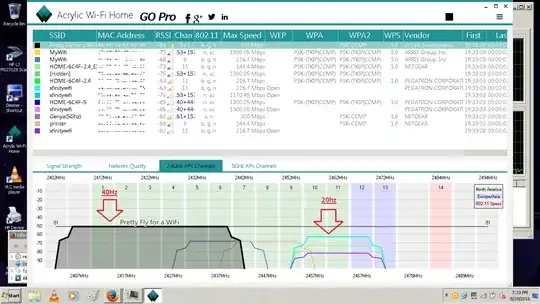

I don't know how so many network people parrot the "1, 6, or 11 ONLY" rule from a Cisco whitepaper that has nothing to do with a home or small office network. My AT&T Arris gateway automatically selects the "best" 2.4 GHz channel from 1, 6 or 11. It selected Ch 1,and my speed was 29 Mbps with lots of error correction on a 100 Mbps line. On a WiFi analyzer, you can clearly see the problem with using only 1, 6, or 11 "because they don't overlap" But the channels overlap by design, and various orthogonal and spread spectrum modulation methods let them coexist with little or no interference. But nothing degrades speed and causes errors as much as having multiple strong signals on a single channel. I have to go into the setup menu to change to Ch 8, (are you sure you want to make this change? Really sure?) and wireless speed is 90 Mbps.![WiFi analyzer channels]]1
Provasek
  • I’ll admit that this rule is based on older modulation techniques. I would be interested in seeing some study, not just your anecdotal evidence. – Ron Trunk Oct 10 '22 at 23:53
