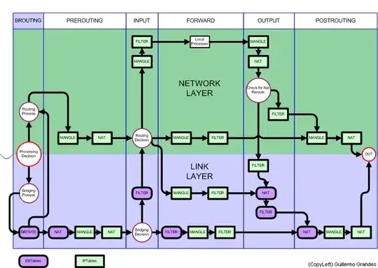

When is a new layer-2 header constructed for forwarding the packet to the next router or host? That happens after a routing decision has been made. That routing process can be complex; see the below image for an example of how Linux's iptables system does it. But at the very end, the out step, that's when all information needed to assemble the new packet is known. The process of creating the new packet is sometimes called the L2 Rewrite process, because most of what it does is replace the layer-2 header.
Linux IPTables
