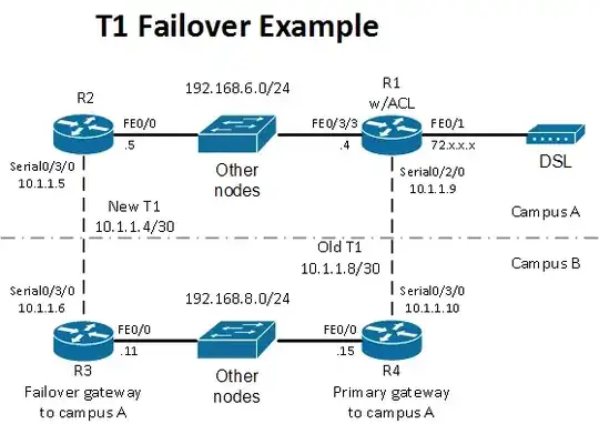

I have inherited a small, insular, dedicated network which is essentially trouble-free, so naturally I want to improve it :-) I lowered my network knowledge and savvy to somewhere around a 2 to 3 on a scale of 1-10 after reading networking posts here. I have only included the pertinent routers in my diagram for clarity.
Currently there's a mix of roughly 6-8 Cisco 2800 and 2900 at each campus with voice cards for a dedicated homegrown application, using static routes to get packets between the 2 campuses. They are running c2801-spservicesk9-mz.124-3g on R1 and R2, and c2800nm-adventerprisek9-mz.124-15.t3 on R3 and R4.
This is a fixed, unchanging network that serves only this dedicated application. No desktops nor laptops coming and going, just the Cisco routers connected via third party fiber muxes in a ring topology on each campus with a couple server machines connected (part of the "other nodes").
Sometime along the way the customer decided it would be a great idea to install a second T1 between R2 and R3 for redundancy. Based on my tests the static routing has no way of employing that second T1. Even with AD/metric on a secondary route to the new T1 only the router whose T1 has failed knows this, but the other routers on that campus do not.
I was considering using ip tracking objects after reading such solutions here to keep things simple and minimize upset to the network. Then I read where EIGRP is the preferred way to handle this.
But if dynamic routing is the way to go it must be implemented in a way that does not disrupt service. This is all remote to me and would require me to arrange a local technician to be standing by in case I lose connectivity during reconfiguration. Hopefully with such a small, unchanging network this disruption could be minimized.
So should I be researching how to employ ip tracking objects or EIGRP to accomplish this T1 failover routing?
EDIT: Here are the currently configured routes for R4. I'm pretty confident that there is some cruft here, but I tried exactly one time to simplify it and backed off when I made one tiny mistake and lost connectivity to Campus B. Outages are a big no-no. I decided to leave well enough alone until I devised a better approach.

The route configuration for R3 is simple:
ip route 0.0.0.0 0.0.0.0 192.168.8.15
ip route 0.0.0.0 0.0.0.0 10.1.1.5 110
I think you’re finding that this is rarely the norm with networking, even with unchanging networks; hence, why you’re here asking how to automate this. Eventually, another link comes online that requires you to reengineer all of your previous efforts. This is, by definition, what the purpose of a routing protocol is. It’s to make sure you don’t have to use static routes everywhere!
You can setup a sort of IP SLA that can keep your system running how it is while still allowing for failover in case your Old T1 goes down.
An example of this type of configuration for R4 would be something like this.

But, as you’re quickly finding out, is the less than ideal way of doing this. Automating this with EIGRP is probably your best bet since you have all Cisco hardware.
If you setup EIGRP in conjunction with your static routes. EIGRP neighbor relationships will be built and your routing tables will be populated with routes to the different locations. No outage should really occur, because your routers will have a fully populated routing table with knowledge of how to get to the other subnets.
Just remember, once everything is setup and running smoothly with both EIGRP and static routing, your still going to use your static routes until you remove them. Done properly, you shouldn’t even notice a blip in traffic flow.
Compare your previous configurations with an example EIGRP configuration for R4.
R4(config)#router eigrp 1
R4(config-router)#no auto-summary
R4(config-router)#network 10.1.1.8
R4(config-router)#network 192.168.8.0
It’s usually that simple for such a small network.

  • The key for me is that you pointed out that the static routes take precedence over dynamic, so I will use that to my advantage. I'll research if those boxes will support EIGRP and implement it if they do. Thanks! – Bote Man Mar 04 '14 at 20:26
  • @BoteMan Read up more on Administrative Distance, that should put you off in the right direction. – Ryan Foley Mar 04 '14 at 20:52
  • Yeah, I did, both when I tried it a year ago on the posted routes and just the other day when I revisited this issue. I have a gut feeling that dynamic routing is the answer after reading many solutions here, but knowing so little about it I did not want to delve in and leave a mess.
    This whole thing started when I realized that the AD only comes into play when the router has a choice of 2 of its own interfaces, but no other routers on that LAN have a clue that they should suddenly use a different gateway somewhere out there to reach Campus A.
    – Bote Man Mar 04 '14 at 21:34
    Administrative distance comes into play when a router knows of the same route in it's RIB and needs to decide between them. In your isolated environment, you won't need a default-gateway on anything other than your servers; you're routers will have complete knowledge of how to get to everything else. Best case scenario: when (not if) you have a link failure, you won't even realize it. – Ryan Foley Mar 04 '14 at 23:24
  • @Fizzle Hmmm. Just to clarify in my mind, you're saying the routers will have complete knowledge by virtue of EIGRP? Because as it is now with the above listed routes the 2 servers on Campus B can't reach out to the DSL link, so those are proven not to work. If dynamic routing ends up being smarter than the Human I'm all for it. TNX. – Bote Man Mar 05 '14 at 00:53
    @BoteMan I'm not entirely sure what is on the other end of the DSL line. If it is controlled by your ISP, then you'll still need a default route on R1 to reach the outside. If you control whatever's on the other end of the DSL line, then yes, each router should have complete knowledge of every other route and your servers will be able to access the DSL line. – Ryan Foley Mar 05 '14 at 06:59
