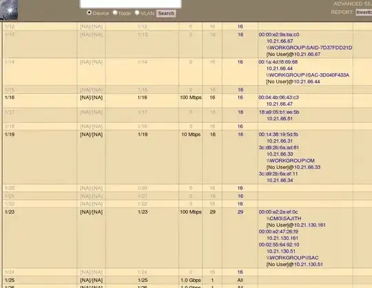

Netdisco listing all ports and corresponding MAC addresses Netdisco listing all ports and corresponding MAC addresses
I want to retrieve all MAC addresses from individual ports. The Q-Bridge MIB shows all the ports on the switch but unfortunately the MAC address OID is not accessible. On the other hand, using the Bridge MIB lists only MAC addresses from the default Vlan. P.S: the community string indexing ( coommstring@vlanid ) to access other vlans only works with CISCO switches.
