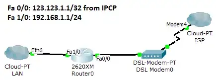

Here's a sort of a diagram of what I have:
Network Diagram
The DSL modem is set up to act as a bridge so Router0 does authentication and sets up connection via PPPoE to the ISP. The Router0 gets an IP address on its WAN interface (Fa0/0 on the diagram) which is from a /32 subnet using IPCP. It only receives a single IP address on the WAN interface and IP aliasing isn't being used here.
I understand what goes on from the Router0 to the LAN. What I don't understand is how does the Router0 communicate with ISP.
