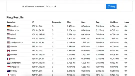

Result from all over the world using - https://tools.keycdn.com/ping
its pure CDN base domain.
