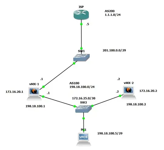

Just for sake of interest I've built a test topology, which displayed in image below:
Little remark: all router's configs are pretty much default. What I did:
  • ISP router with loopback of 1.1.1.1/32. Announcing route 1.1.1.0/24 via BGP to vMX-1. BGP session to vMX-2 not configured;
  • vMX-1 and vMX-2 share virtual IP 198.18.100.3 via VRRP; this IP is set as default gateway for PC1 (198.18.100.5);
  • vMX-1 announces 198.18.100.0/24 to ISP;
  • Connection from vMX-2 to ISP deleted intentionaly.

Ping from PC1:
PC1> ping 1.1.1.1
84 bytes from 1.1.1.1 icmp_seq=1 ttl=254 time=12.161 ms
84 bytes from 1.1.1.1 icmp_seq=2 ttl=254 time=12.250 ms
84 bytes from 1.1.1.1 icmp_seq=3 ttl=254 time=5.690 ms
84 bytes from 1.1.1.1 icmp_seq=4 ttl=254 time=9.649 ms
84 bytes from 1.1.1.1 icmp_seq=5 ttl=254 time=2.823 ms
Trace:
PC1> trace 1.1.1.1
trace to 1.1.1.1, 8 hops max, press Ctrl+C to stop
 1   172.16.25.2   2.584 ms  0.861 ms  0.645 ms
 2   172.16.25.1   2.450 ms  1.736 ms  1.723 ms
 3   *201.100.0.5   9.231 ms (ICMP type:3, code:3, Destination port unreachable)
I think your configuration is simply lack of next-hop self policy for iBGP.
